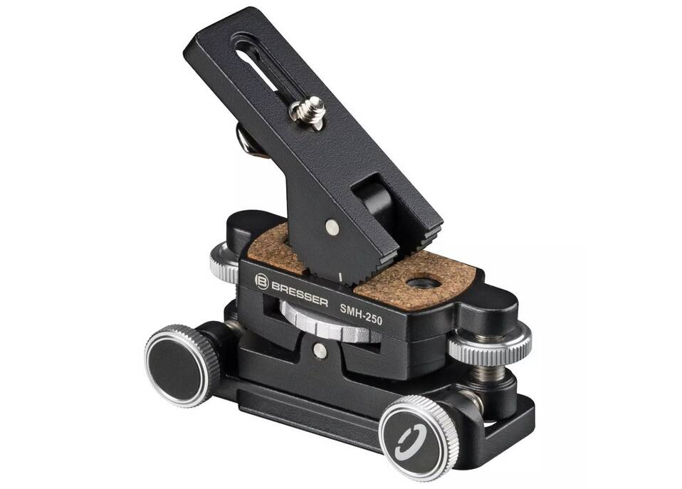

To ensure parallel alignment, I previously used a leveling base and a 3D micrometric head from Manfrotto, but the most stable and convenient option I’ve found is this small telescope accessory :
