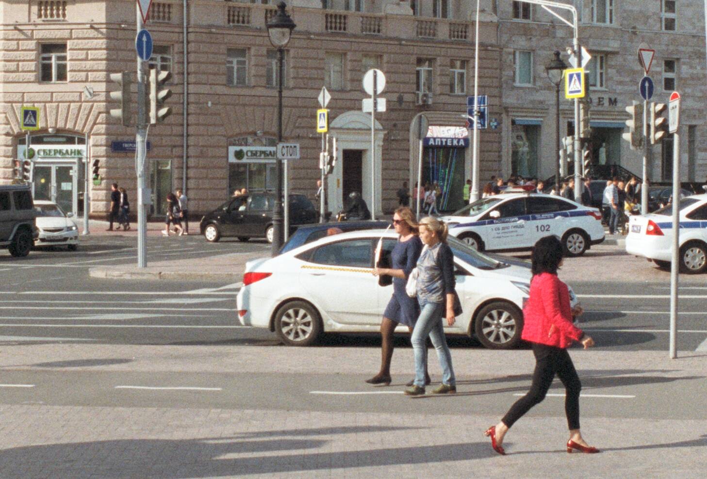

For contrast, here is Silverfast HDR conversion which looks more natural to me:
Both jacket is more red and ‘lime’ padding around pedestrian crossing street signs looks correct only in SF version, in NLP they are more like orange.

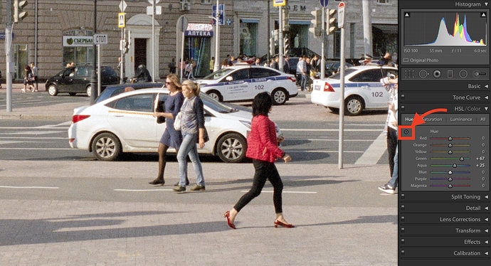

Another trick you may find helpful is using the HSL panel in Lightroom against the original RAW file (instead of on the positive copy). To do this, first give your conversion in Negative Lab Pro to something you like, then hit “apply”, and then in Lightroom, click the little circle so you can adjust hue/sat/lum by clicking and dragging in the photo (by using the tool to drag in the photo, you don’t have to worry about what the underlying color in the original negative is.) Just be sure to try both saturation and hue adjustments!
Here’s what that looks like spending 5 seconds adjusting the hue/saturation of the jacket.
