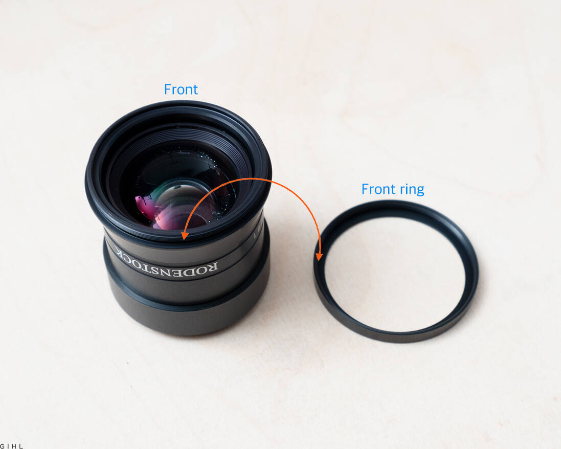

I removed the lens from the Flexight II scanner.
It will be removed by simply turning the lens.
The lens was a Rodenstock Magnagon 5.6/75.
And I was able to loosen the retaining ring on the back of the lens, and a red filter was inserted into it.
The thread on the back of the lens is 39mm.
There is also a retaining ring on the front of the lens, but the filter is not attached.
When using on a camera, it seems that the rear retaining ring on the back of the lens needs to be removed.
And put the red filter on the front of the lens with a front retaining ring.
So what I need is the M39-E-mount adapter like the one below?
