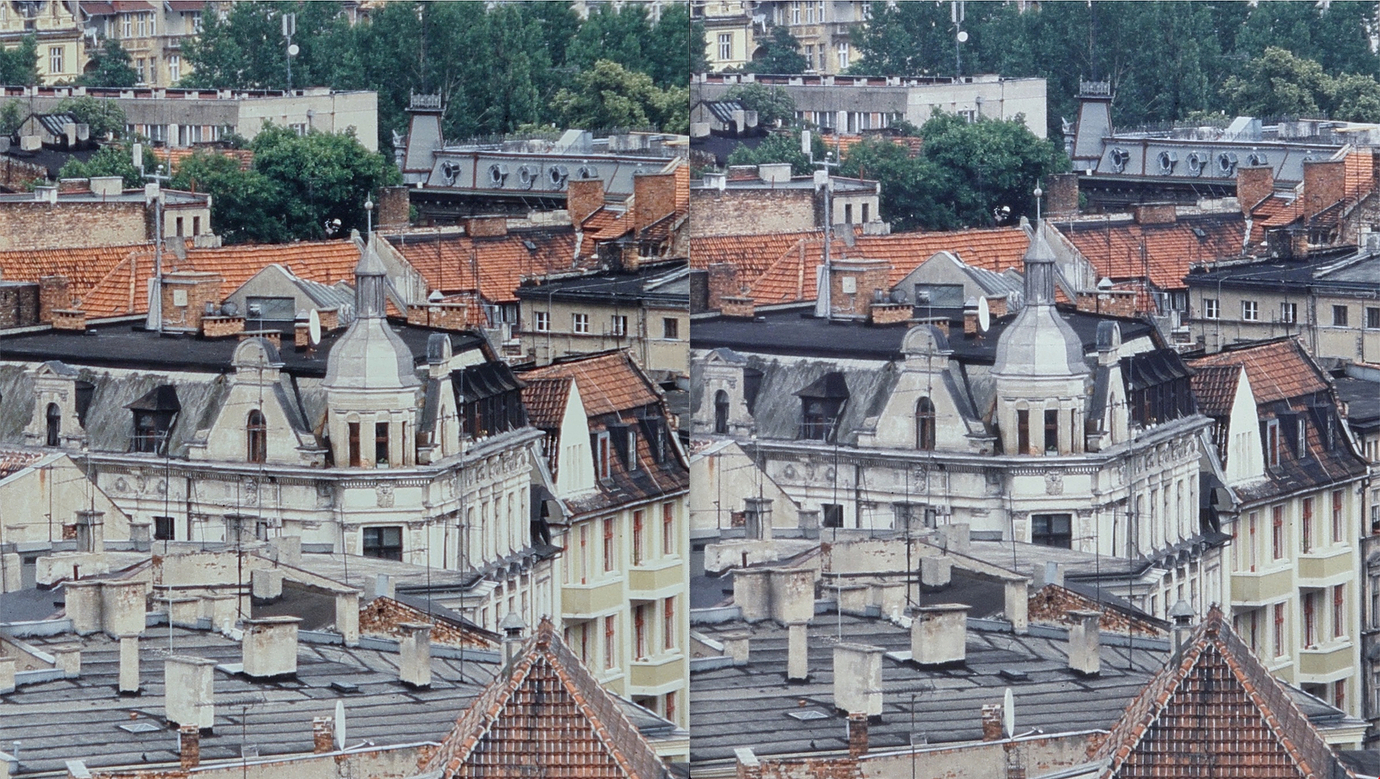

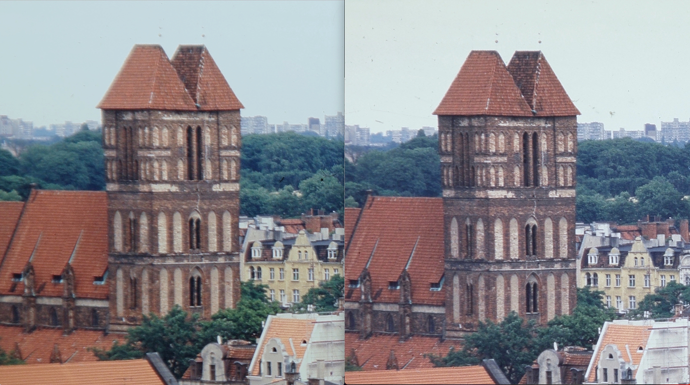

Here is a quick & very :slight_smile: dirty test. A 24 MP camera is “hanging” attached to a filter thread of an enlarger lens, which in turn is attached to an enlarger in the usual way, meaning, the same as if you would print on a paper (not reversed).
The slide is Fuji RD 100 ASA, and the lens is Schneider Componon-S 50/2.8. The picture on the left is taken at the 5,6 aperture, the picture on the right at the 11. Screenshots are at 100%. First middle of the frame, second frame edge.
Surprisingly, I see very little image degradation due to diffraction. The original slide is sharp edge to edge.
Maybe I am doing something wrong and/or the lens is out of its scope, like a rangefinder lens attached via an adapter to a mirroless cam?
The pictures on the right look a bit crisper to me. Maybe that focus wasn’t perfect and f/11 brings in details lost with lesser DOF of f/5.6.
You could, imo, try to go further in thirds to f/16 or even above that. At one point, diffraction will creep in visibly.
Sure, focus errors are possible, but that comes with the territory. At least I would accept them, to a degree, when I would want to work fast.
For my eyes, centre of the frame @5,6 looks crisper (left image). Might be slight differences in contrast, as well.
The appearance of “sharp” is subjective and changes with contrast … and noise. Leaving some luminance noise can make an image look sharper. When the advanced NR features were introduced, I applied DeepPrime and added back some grain with FilmPack. Looks like our brain is doing the sharpening in such a case…
You are right, but anyway, the edges of the “scan” are not acceptable.
With my Epson flatbed, I can count bricks on the towers, and here, there is an indistinguishable mush…
Is this test designed to illustrate the effects of diffraction, or the effect of reversing an enlarger lens on a digital camera, or the feasibility of mounting a digital camera body to an enlarger in this way?
An enlarger lens is generally specified for magnifications of, say, ‘2x to 20x’ which handily covers most sizes of prints that anyone would need to make. It doesn’t mean that it will be optimised for either 2x or 20x, so somewhere in between. For film copying with a digital camera you take the reciprocal of this if you mount it to the camera in the normal way (i.e not by the filter ring, reversed) so 1:2 to 1:20. Alternatively if you reverse it then the magnification range reverts to 2x to 20x for film copying and this is why something like a 50mm enlarger lens can be very successful reversed for copying cine film on to an APS-C or 4/3 sensor. Alternatively 75/80mm enlarger lenses, with a larger image circle, can be very good for copying 120 film in their normal orientation.
1:1 is out of its stated range so although by all means try it I’ve not found that reversing an enlarger lens helps to get round the weaker corner definition for 1:1 film copying.
When using Vlad’s 35mm Test Target on full frame or APS-C I’ve found that as a general guide diffraction begins to set in at around f5.6/8 for APS/C and f8/11 for full frame.
