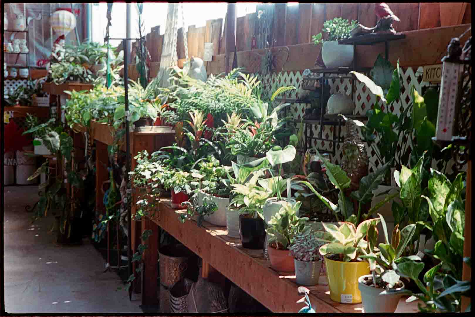

I had a go at the beta, while I am using a v700 scanner, and followed the normal way I do things when I analyze the slide positive, I get this:
What has happened? it didn’t reverse it at all..
On NLP‘s first tab, you‘ll find an option to tell NLP that you are scanning a positive or a negative. If colours are reverset, select „negative“ and you should be good to go.
Unconvert the image before you reconvert it.

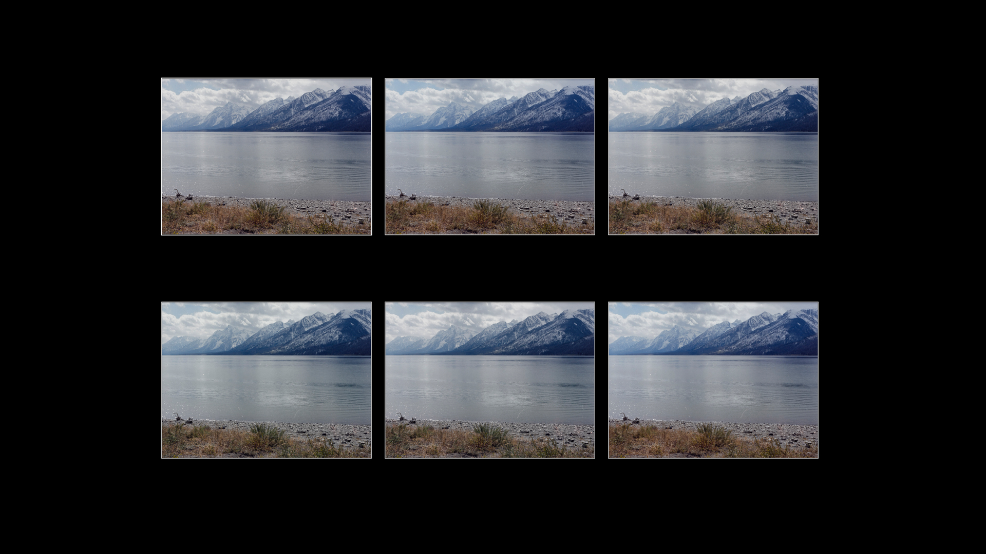

I’ve been really enjoying the conversions out of 3.1! One thing I’ve noticed after playing around with various white balance settings before conversions is that a 5500K +6 (default) tint in Lightroom produces a much nicer conversion than sampling off the film border. Has anyone else noticed this? I find it gives the negatives a bit more density in the conversion.
In theory, white balance doesn’t matter with RAW files. Due to whatever non-linear functionality is built into NLP, results vary - depending on tonal values, LUTs, pre-saturation settings, colour model etc. I propose that you test your WB settings with different kinds of films, and with negatives old and new. If your WB settings give you what you want under various inputs, you’ve found your goldilocks setting.
I find differences to be subtle in most cases though. I’ve come to have Lightroom white balance negatives automatically and find that it works in most cases, even with camera scans of B&W negatives scanned with UniWB settings. Here’s an example:
Conversions with Colour Model “Frontier” and pre-saturation at "1* of images with WB set to “As shot”, “Automatic”, Tungsten etc. And while differences exist, they are small and a matter of taste rather than whoaaa!
Older versions of NLP were delivering results with bigger differences, but NLP 3.1.1 seems to be fairly immune to WB settings, at least with all negatives I tested with. YMMV.
