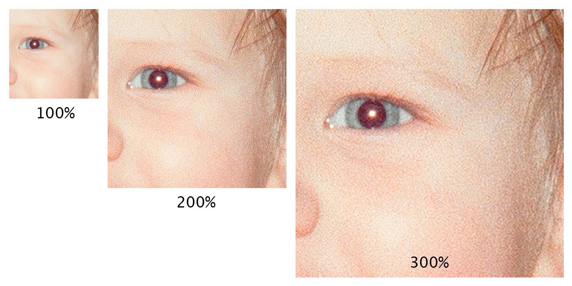

The raw image is 18.0 MP, after cropping I’m left with 14 MP. If I frame the negative better I think I could get close to 16 MP after cropping out the borders. At 100% it looks great, but if I zoom in to 300% there’s noticeable grain.
Would a camera with 28 MP (2 x 14 MP) look the same as my 14 MP photo zoomed in to 200%, or would the increased megapixels and a more modern sensor make it look more like in the 100% grain-wise but zoomed in as the 200%?
If the grains are coming from the the negative film itself, then I assume more megapixels wouldn’t actually make the image appear less grainy or sharper compared to what I’m currently getting?
I suppose one question you can ask yourself is how many pixels do you need. To keep the matths easy let’s say you end up with a cropped frame of 4800 x 3200 pixels then at 300 dpi that’s 16" on the long side, a pretty decent sized print really. I’m not sure aboout that grain, it looks a bit odd to me but maybe try some different negatives with different subject matter and see how it looks in darker tones maybe (i.e. lighter parts of the negative). Is the original negative well exposed?
The good thing is that you can see this ‘grain’ but a more exacting test of the lens and the alignment of your setup would be if it is still there towards the corners. It would be an exceptional lens that held centre sharpness right into the corners but some lenses fall off noticeably.
On the face of it I’d say that was a good result.
