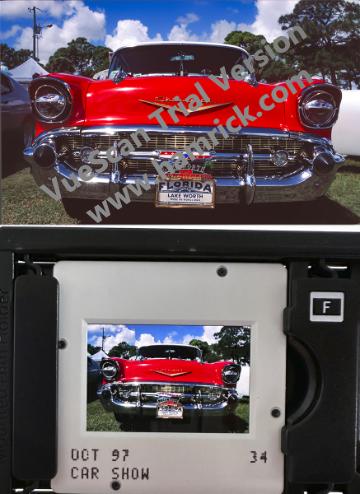

I was sadly surprised to see such poor results from perfectly exposed scanned slides. I’ve been involved in the photographic industry since 1975, developing slides and both colour and black and white negatives and also printing enlargements as well.
I finally got around to buying the Plustek 8300i AE and upgraded the SilverFast software for the autopilot workflow. And although I’m very happy with the speed and outcome when scanning negatives, I am saddened to see it fail so badly when scanning slides.
I understand the principles behind the challenges of slide scanning, but I really thought we had progressed to getting better results with a £400 slide scanner in the 21st century.

I was able to adjust the settings within SilverFast and obtain a slightly better slide scan, and I’ll post an iPhone pic of the slide next to the scan so you can see a side-by-side comparison.

I was able to obtain a better scan using VueScan and I found the software had adjustments that were more easily accessible, more user friendly. I was able to get a closer-matching scan eventually using SilverFast, but neither software produced what I was hoping for. But again, I know 21st century digital has spoiled my visual senses.
