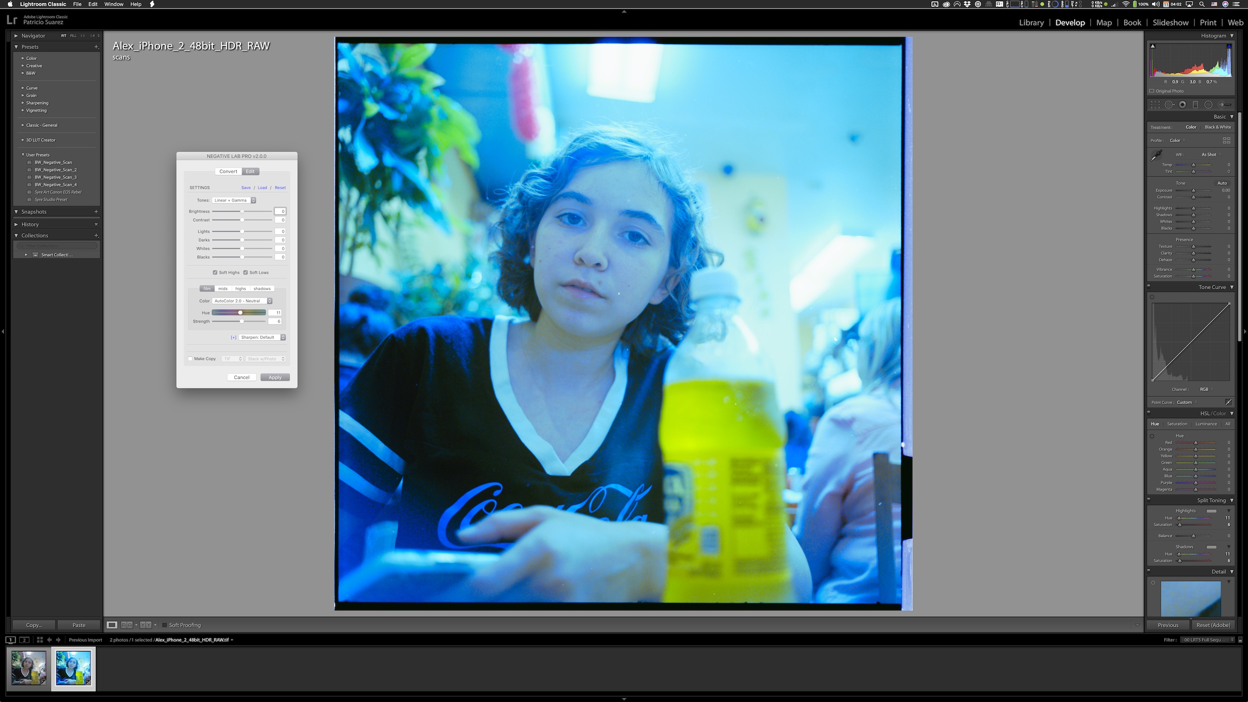

I’ve build the profiles for the Plustek OpticFilm 120 and added to the download link. At least on the files you sent, it seems to make a big difference in terms of getting good colors right off the bat…
Example:
Try it out and let me know what you think!
(Be sure to unconvert and reconvert after successfully installing the profiles… also, probably helpful to reset any previous settings you used in Negative Lab Pro on the unprofiled version… with the new profile, there should be much less blue/cyan cast to remove).
