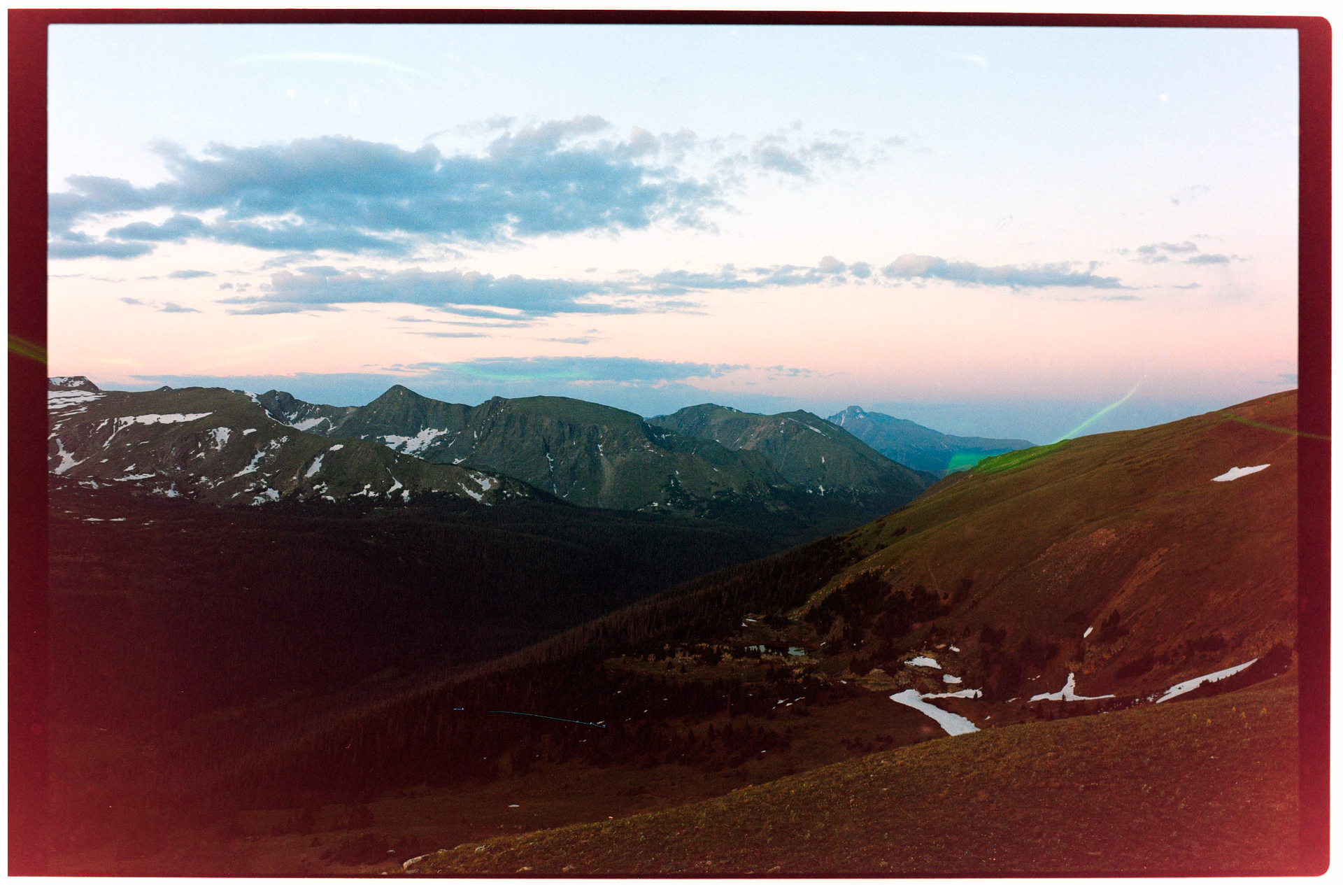

Is this from my scans or camera?

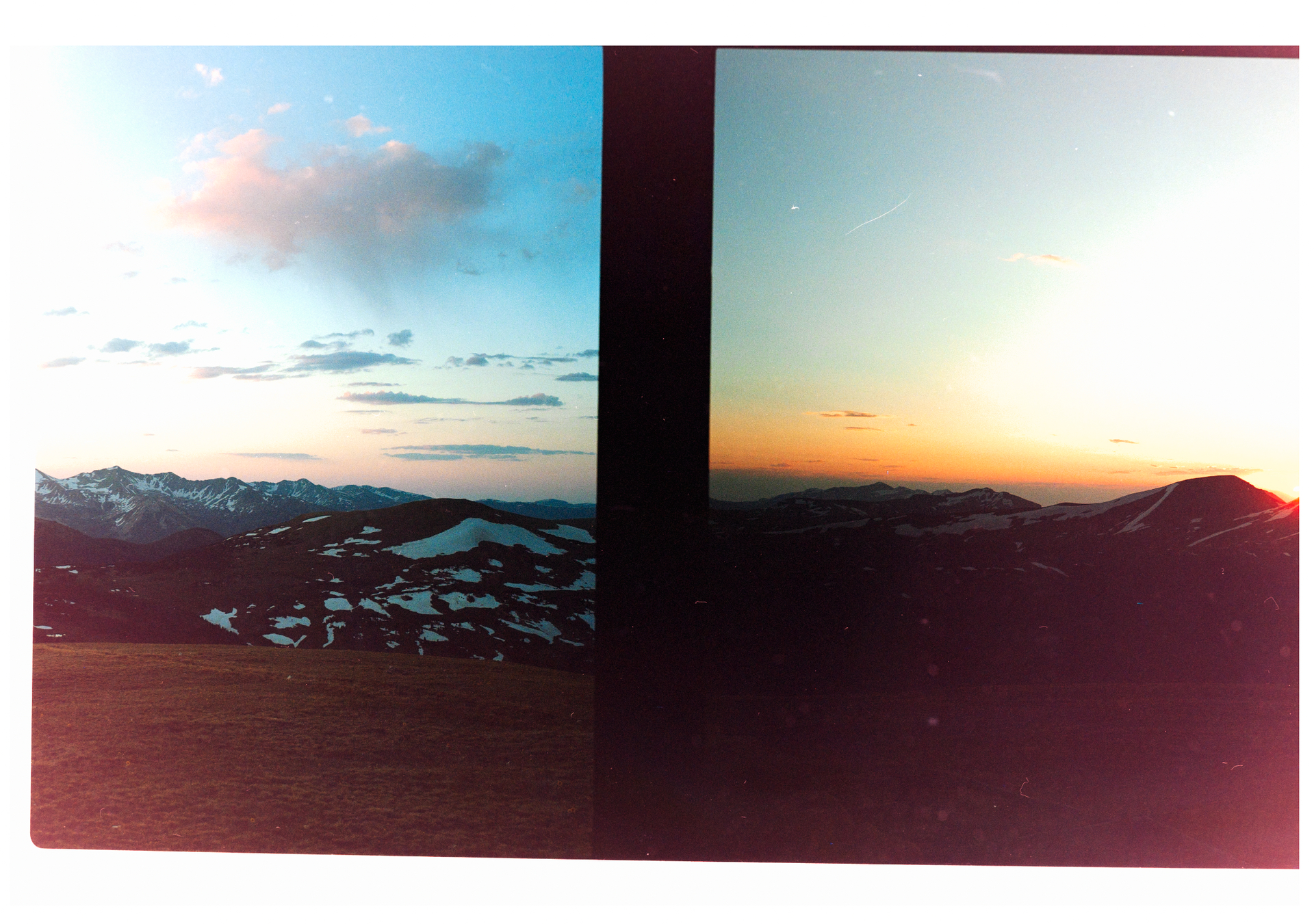

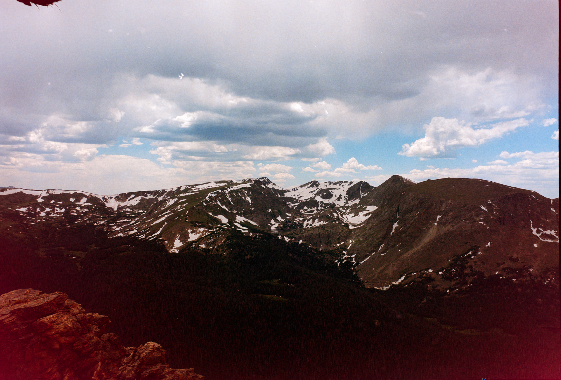

Hi all, on all most all of my photos from my Fuji GSW690ii I have this… almost glare/bleed. Is this from extra light from my scanning light or from my camera?
Thanks for the help.

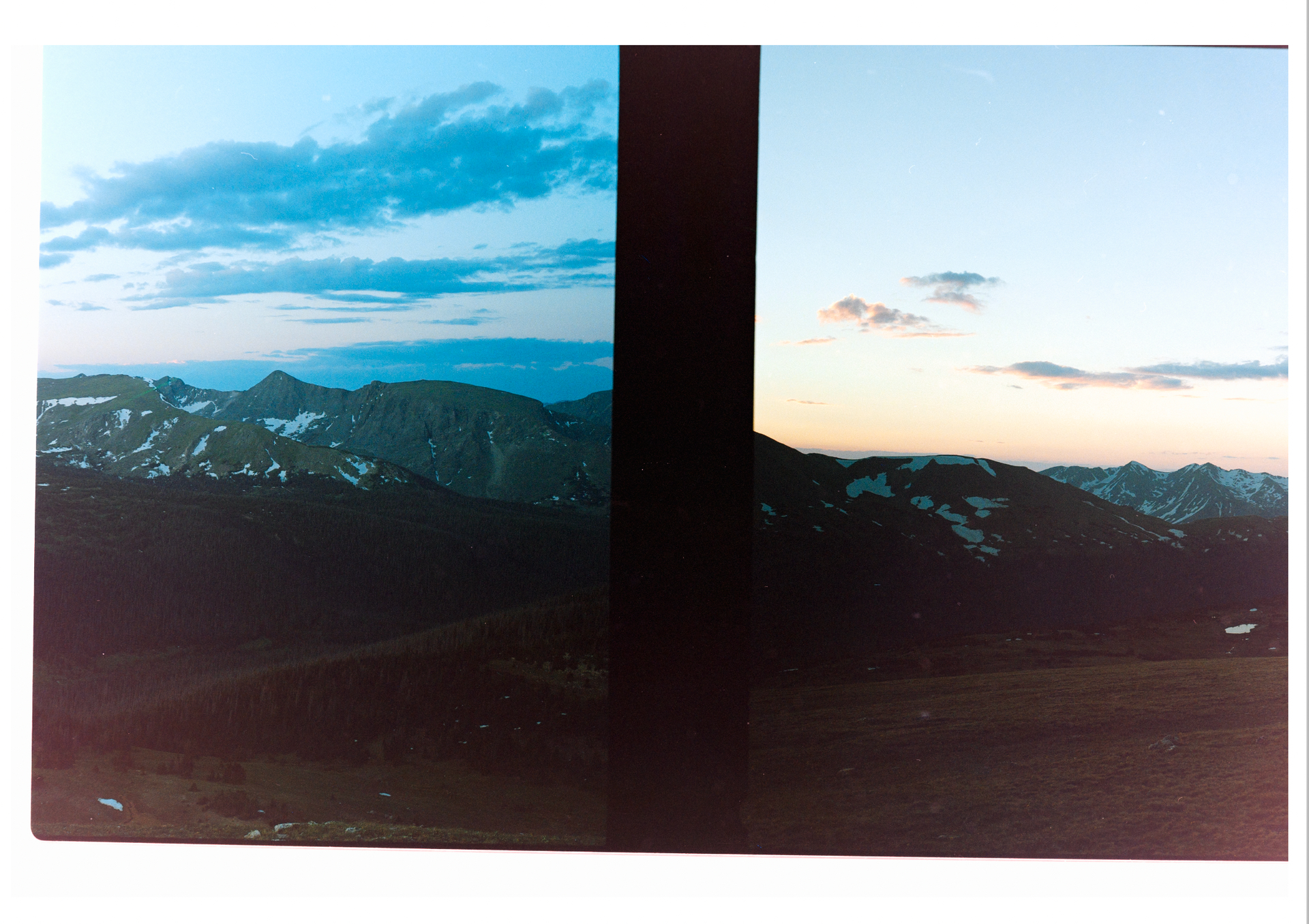

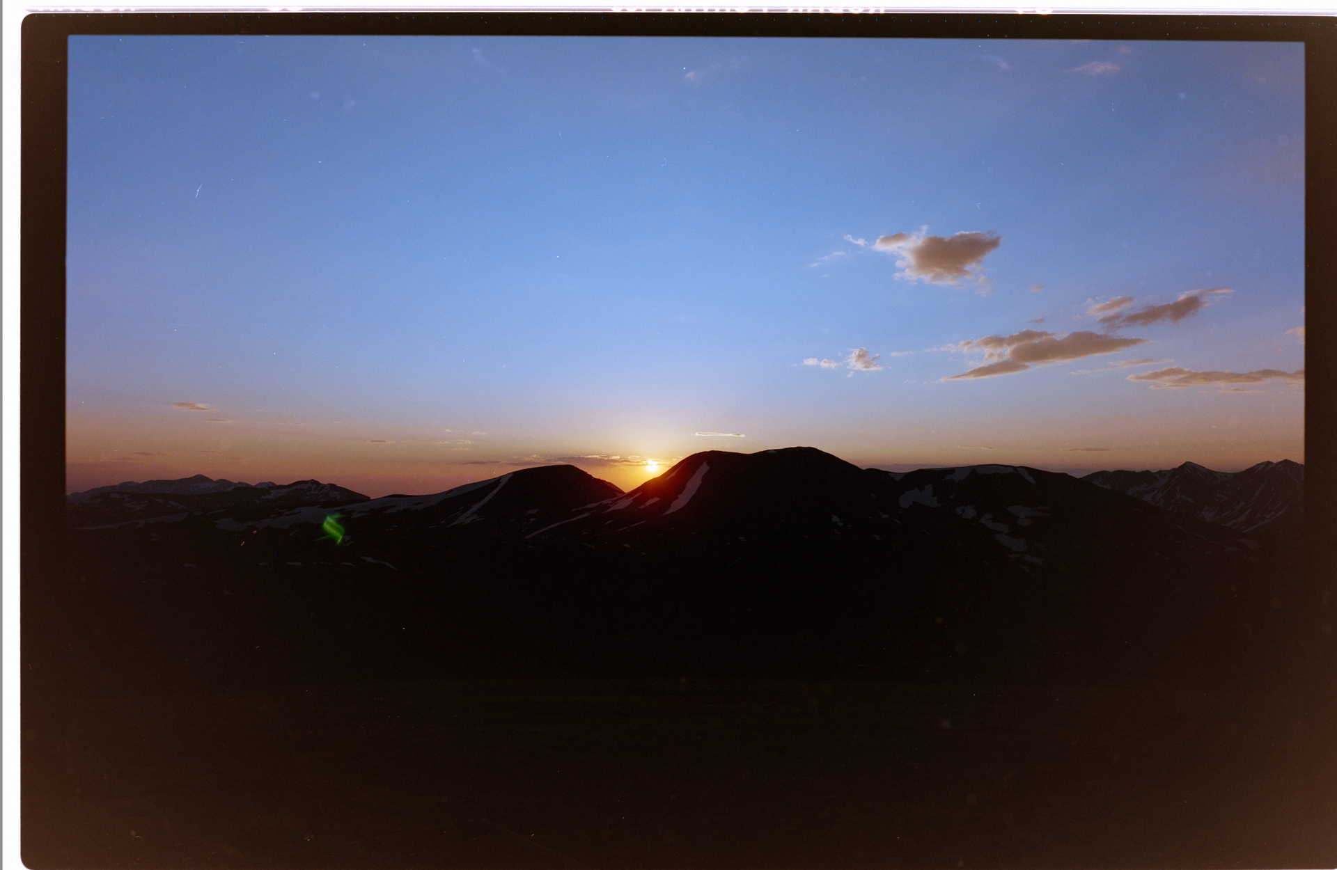

Here’s another example.
If it was from the film camera then you should probably be able to see it on the negatives themselves, easier if you have a viewing light box. However you could try ‘scanning’ parts of two neighbouring negatives with the frame divider in the centre so you get the right hand side of one negative and the left hand side of its neighbour. If you still get that effect in the bottom corners of your scan then it couldn’t have happened in the film camera. Conversely if it is in the corners of each frame then it must be the film camera. You can also scan a blank unexposed frame but with an exposure/shutter speed to get the histogram roughly centred.
Thanks, Harry. I’m afraid it might be light leaks from the camera. :face_with_spiral_eyes:

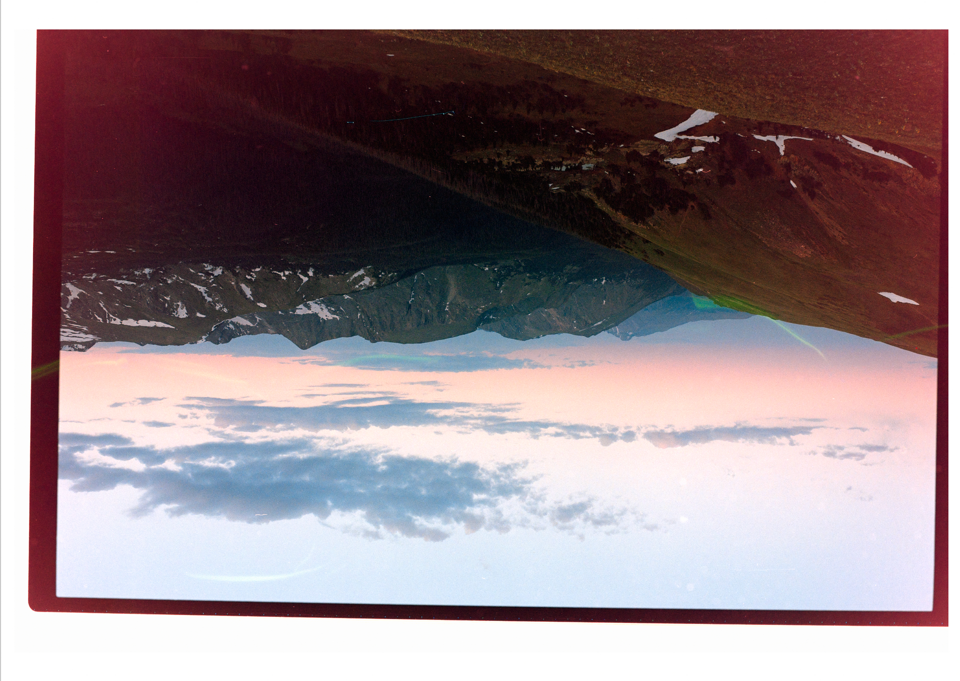

What happens if you scan the flipped image?
That’s not definitive though, not what I was trying to get at, I meant to scan across two frames.

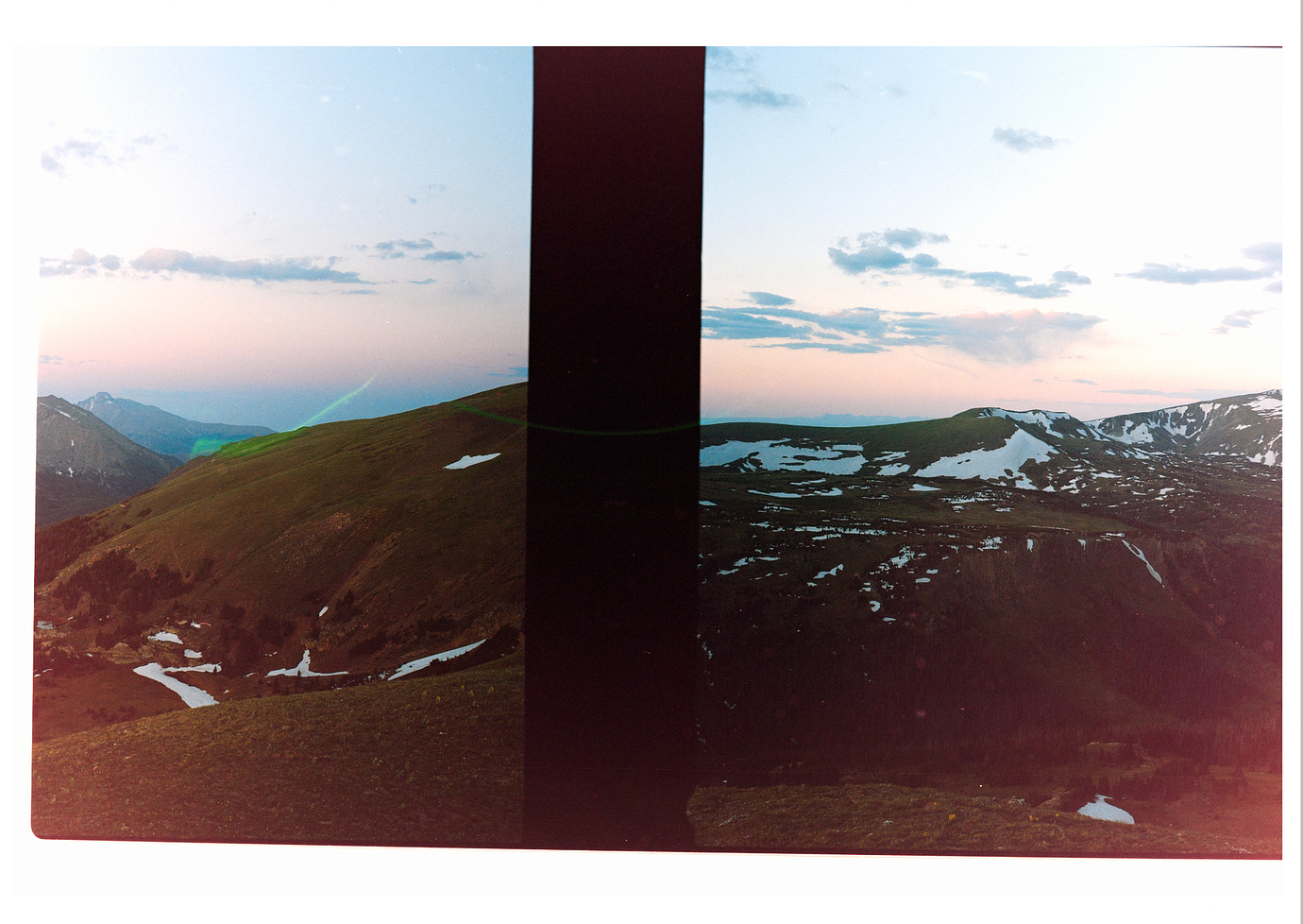

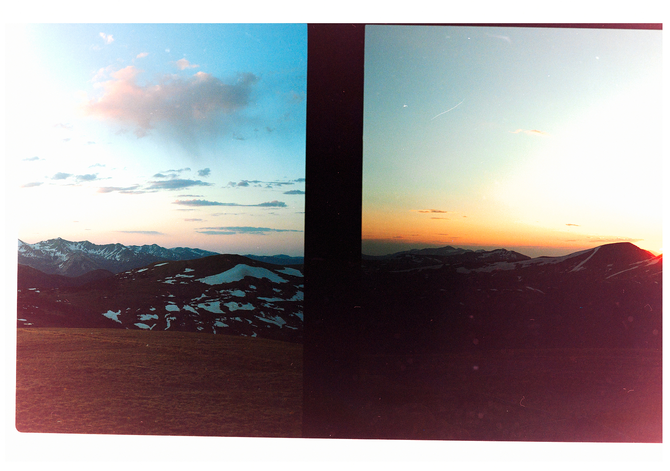

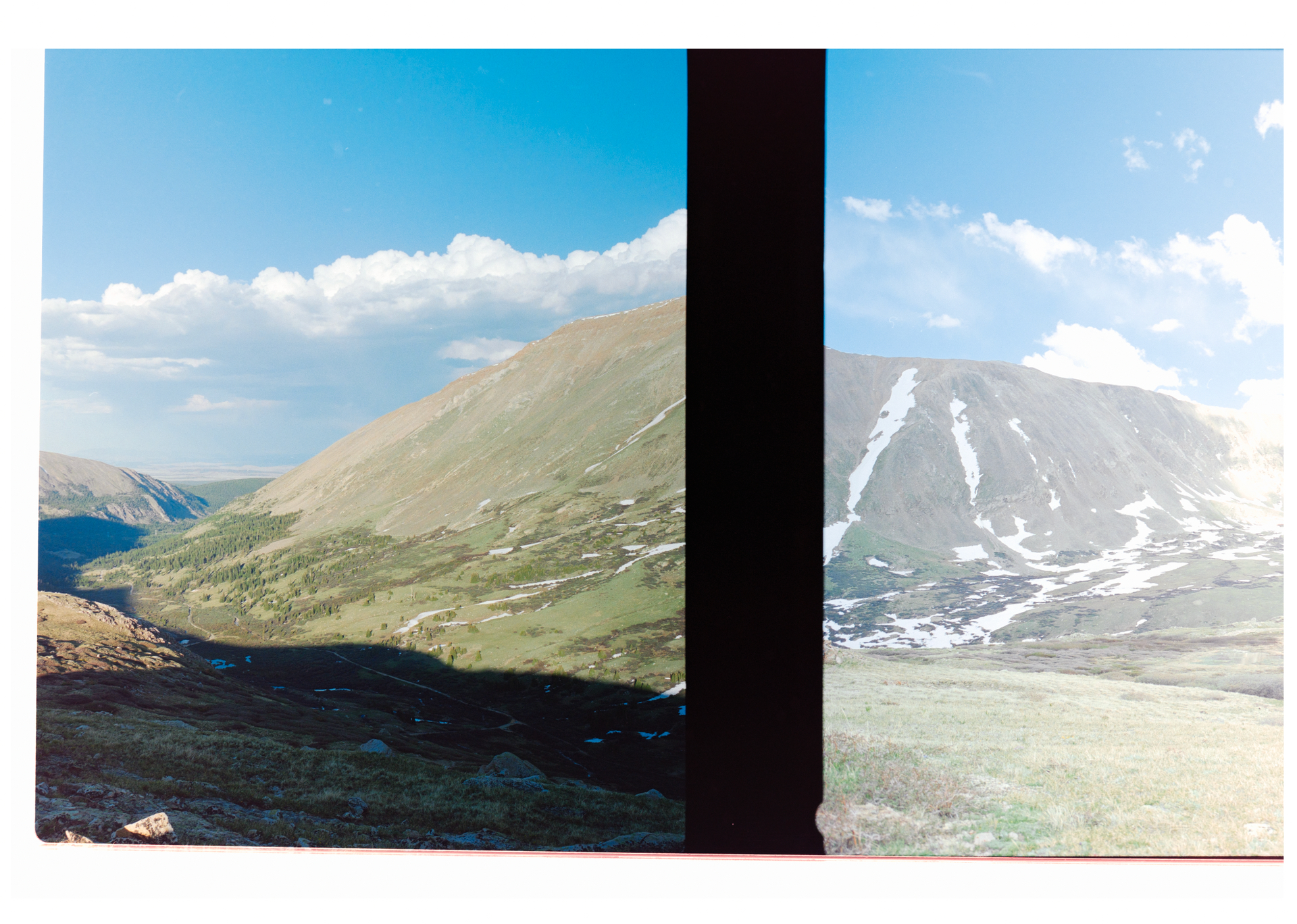

So the vignette still happens when taking a photo across two frames. So that means it’s not the film camera, thank god.

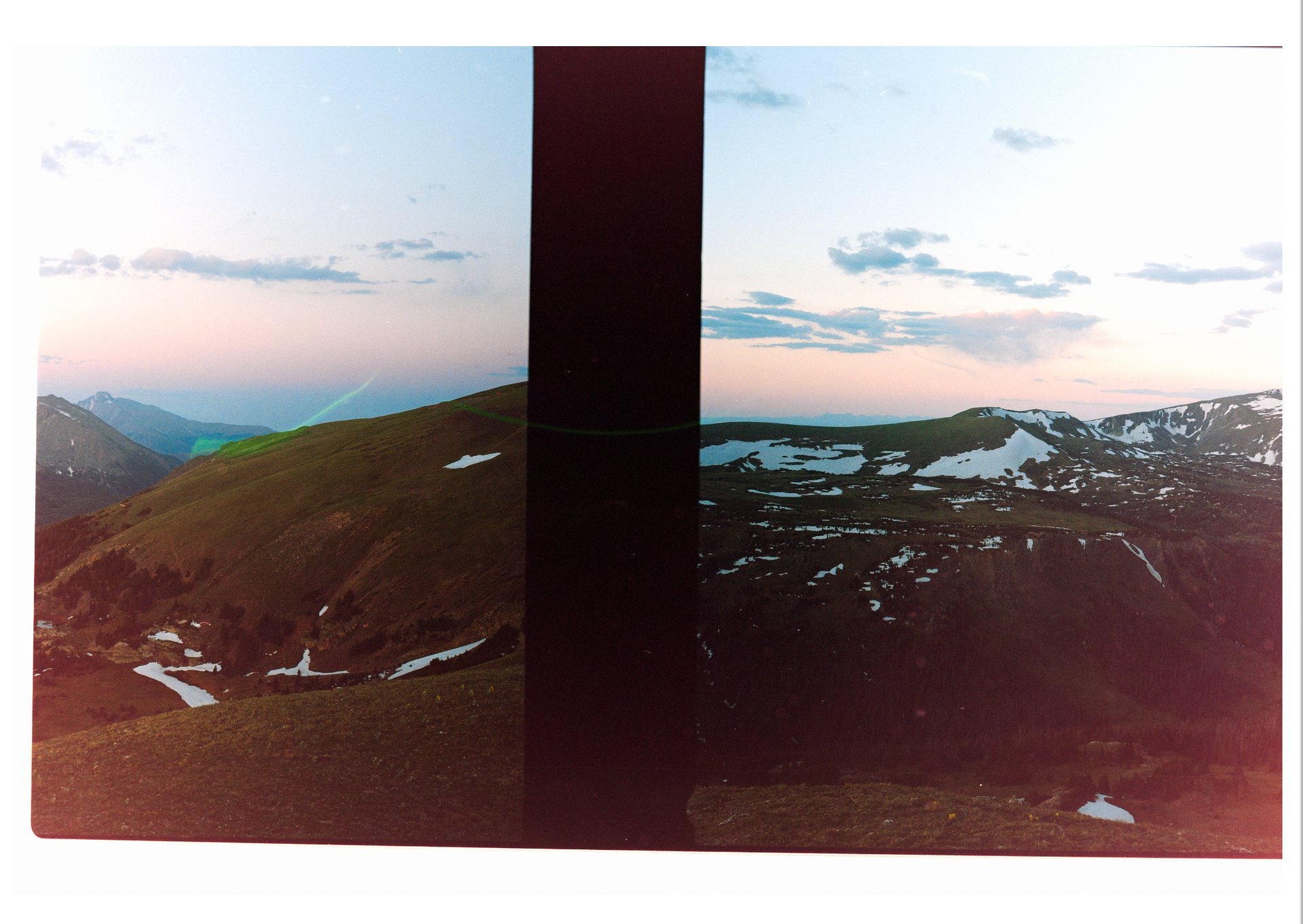

It still happens when the negs are flipped, so again seems like it’s the lens vignette.
What’s odd is that it doesn’t always happen, which made me think it was a light leak.

Flipping the image also flips the issue → The film must be the reason.

Not here, copying across two frames shows there is no problem in the corners of the actual film frame. I think that the problem is in all four corners of the digital capture though.

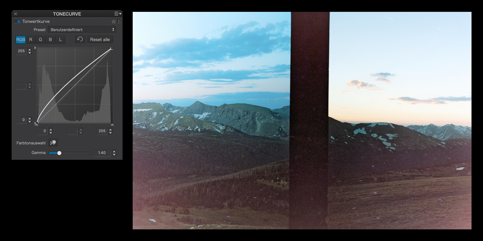

Look at image (number 3 in this thread) and its flipped version (number 6) and foreground corners with their red glow. I see now such thing in the corners with the sky though. This hints at an issue with this image. The images differ in size and crop and the glow is slightly different, that’s why I’d check the setup, which might add to the overall issue.
The strip separating two images has no apparent gradient, but there is some glow in the corners nevertheless. There seems to be an issue with the setup too.
…given the information we have, I can’t point my finger in an either-or manner. To me, it looks like a composite of different issues.

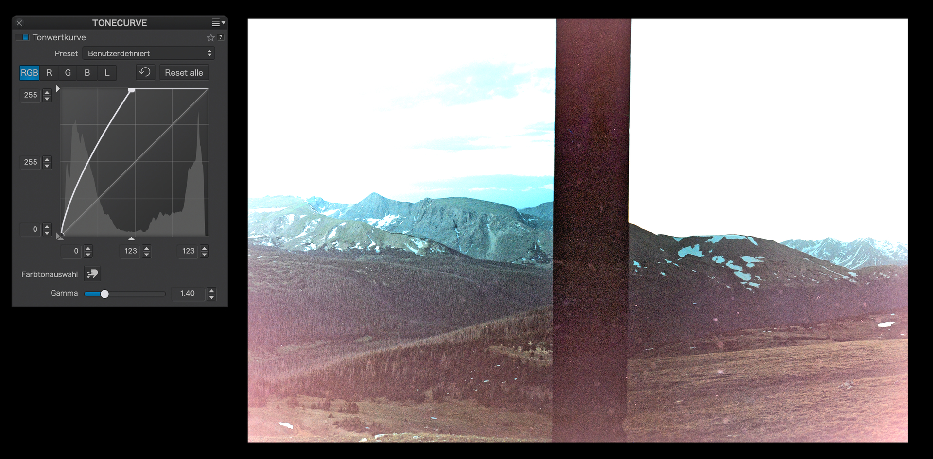

I can see no effect in the two foreground corners visible around the frame separator when the digital capture straddles two frames, other than a very slight spread from the corners of the digital capture which (to me) shows that it is not on the film. To me the reason why the effect doesn’t show in the sky when the film is flipped is that the impact varies in proportion to the density of the image on film, so in the sky (denser on the negative) you don’t see it whereas in the (underexposed) foreground the proportional difference is much greater.

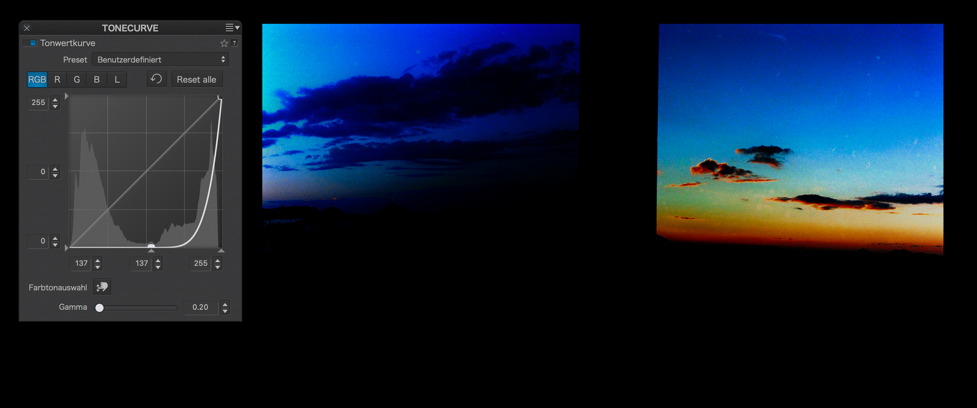

Things aren’t easy to see indeed. So I took one of the posted images and edited them to make differences more visible.
Possible causes of increased brightness in corners or sides
  • atmospheric conditions, lighting of the original capture on film)
  • original capture setup
  • scanning setup
Again, we’re all guessing, and for a definitive answer, we’d need a piece of film (not possible) or at least a few OOC raw files, also of the scanning backlight without film and without film holder.

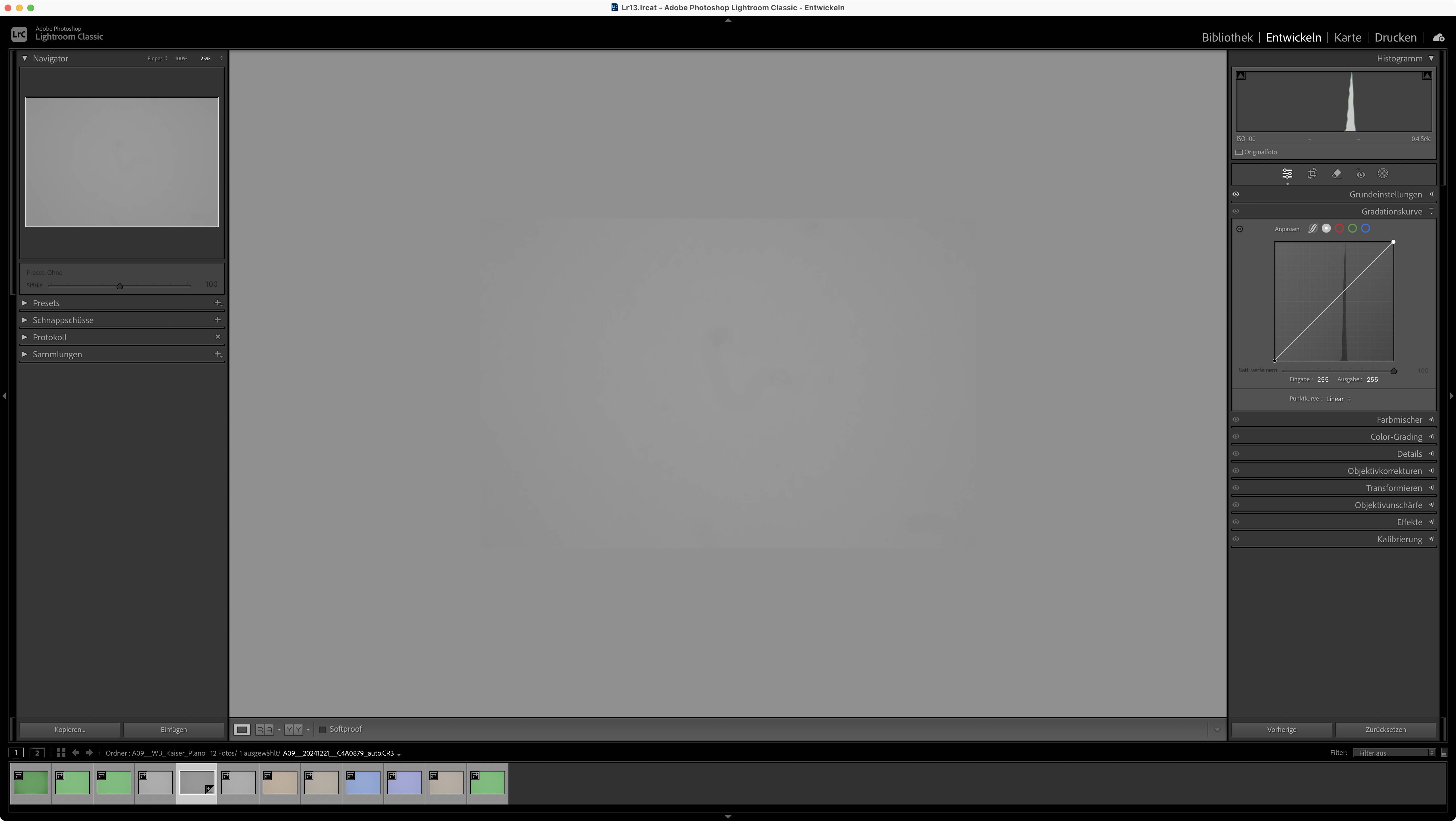

Evaluating the scanning setup

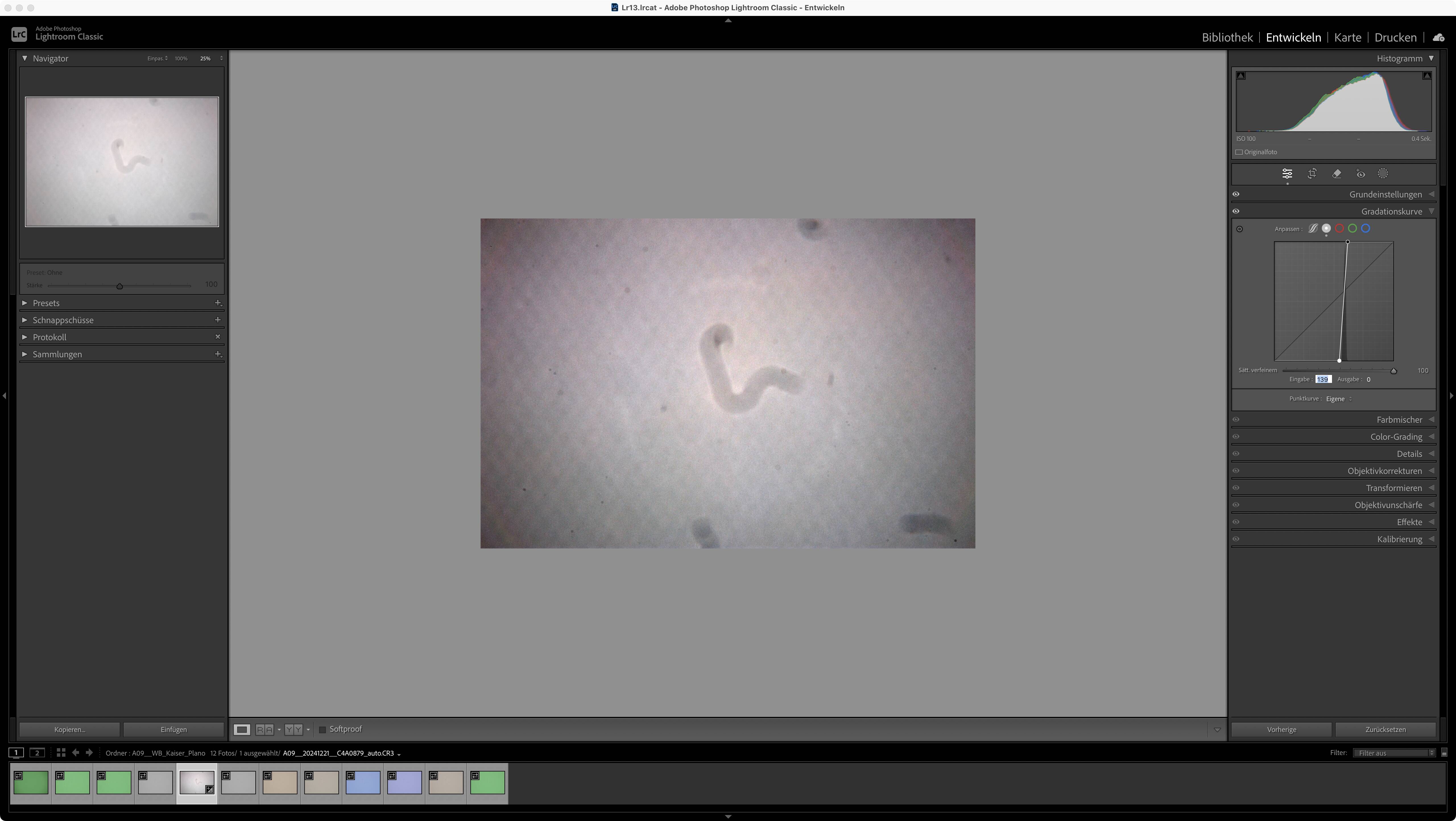

  • Scan of the backlight as seen against a grey background. The histogram is fairly narrow.
    We can still see hints of darkened sides and edges and some dust on the lens. Under normal conditions, this setup is good for all but the most demanding negatives.
  • Enhanced representation, note the wider histogram and the aggressive tone curve
    Now, things look terrible. We can see lens falloff, dust … and the diamond shaped structure of the light spreader of the Kaiser Plano. We can also make out the text printed in white on the front of the 7Artisan 60mm macro lens. Under normal conditions, only the dust will matter.
