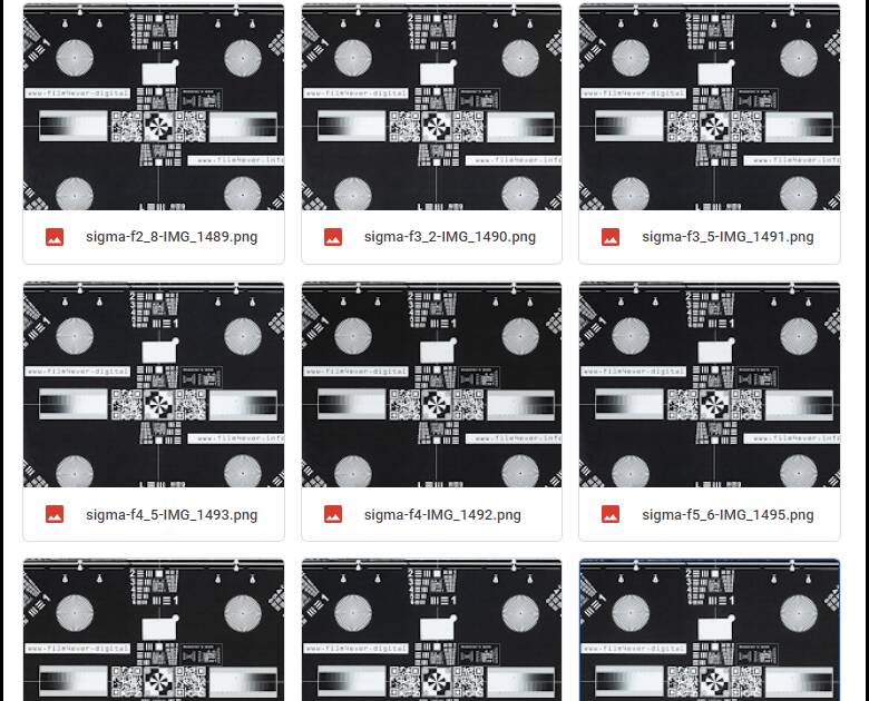

Next up: testing for the sharpest aperture, and then I’m good to go.
