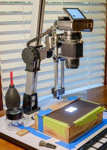

Fuji X-T1 camera, Pentax bellows, Rodenstock APO-Rodagon D 75mm f/4.0 lens, home made light box containing a Nanguang CN-T96 96 LED Light, all on an ALZO Copy Stand.
A few details about making the box for the LED panel <here>
Still to do: make a platform to hold the negatives which is independent from the light source. I am thinking about using the LED light panel box for focusing, then switching to an electronic flash for the exposure.
