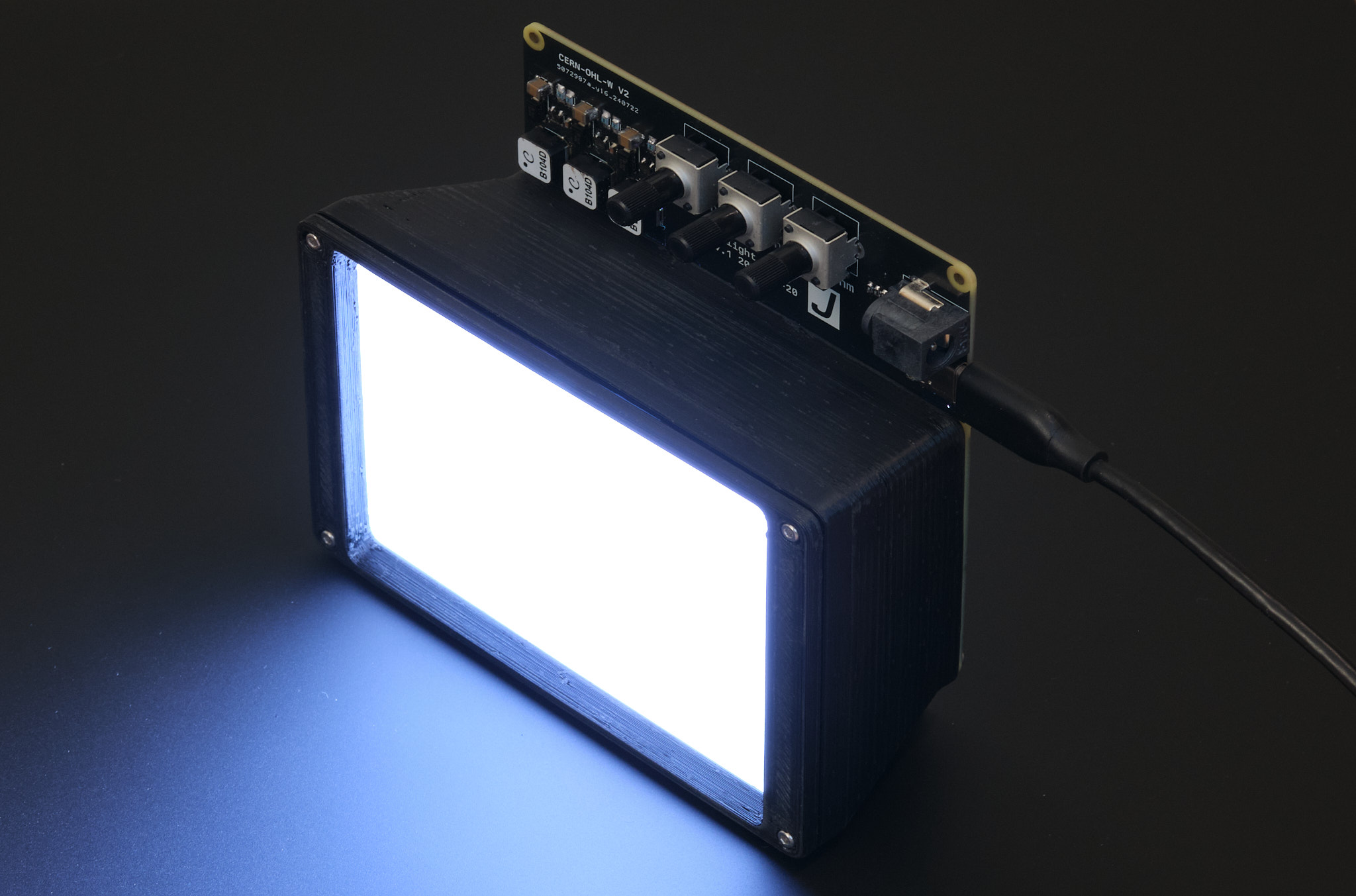

With that in mind, I recently aquired Jack Whittaker’s “Big Scanlight”, which you can read about here:

I am also using Jack’s big scanlight. There was one issue that I ran into that I had never seen before with white light; Vignetting causes a tint shift as well. I am getting varying white balances between the center and corners of the image which needs to be corrected with FFC or a custom radial mask. It creates red flaring in the conversion. I thought it was maybe caused by the lens but I saw similar characteristics when using different glass. Here is an exaggerated example:
Correcting for this has been the biggest change in my workflow.
Interesting, I haven’t noticed this, I’ll have to investigate. I was getting weird color shifts when using FFC since in Lightroom FFC also does color correction. Changing the color profile of the calibration frame to monochrome fixed the issue such that it only corrects for light falloff.

If you shoot a blank shot of just the light source, and jack the contrast way up, you will might see a color vignette. I have the Big Scanlight as well, and the pattern seems independent of the distance from the panel. I’m using a Sony with a Sigma 105 Art, and get the pattern whether the film is sitting on the panel or raised pretty far. I’m guessing it may have something to do with sensor edges and rgb light angles.
FFC fixes it, but I find it to be a cumbersome workflow. I wish NLP had its own FFC function (hint hint).
