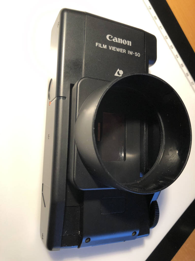

Success! found a Canon IW-50 Film Viewer on eBay and it arrived this week. It’s a great mechanical solution for reading the film and I needed to graft it on to my macro lens (Nikon 40mm F2.8 DX Macro). I found an easy solution with a Nikon K5 Extension ring and an elastic band to increase the diameter for a. snug fit. Here are some photos. So a great scanning rig and a million thanks to TJ Longacre for pointing me in the right direction.
And here is what the overall rig looks like. I use it with a Nikon D5300 (24MP) and Helicon Remote to tether to my MacBook. Light comes from a Nikon Speedlight Flash.
