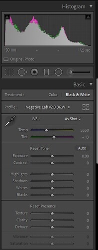

The colorization (much less frequent) is really baffling. Here are two Histograms, the first from an image resulting from a batch process (several hundred images), the second from processing the same camera image singly. The two histograms differ in the Red/Green/Blue channels. The colorized one has a depressed green channel, producing a magenta tint, and in other areas the red/blue channels are depressed, producing a green tint. The singly processed image has all three channels equal.

Hi @plummerl - if you are seeing any kind of colorization on your black and white, see this article: Solving Image Issues | Negative Lab Pro
  1. Make sure that during conversion, you set the color model to “B+W” - otherwise the resulting conversion will not be perfectly black and white.
  2. Hit the “RESET” button (above the tone section in Negative Lab Pro) to zero out any existing settings. If your saved default settings include some kind of color toning, that toning will be applied, even to the black and white image. You can go into each of the color tabs to zero those out, or just hit the “RESET” button to zero everything out.
I’ll just add to that to hit the “save” button so that your future batch conversions will default to settings that do not have color adjustments.
Thanks Nate, however in every case the issues I’m seeing are with Color Model set to B+W! That’s what was so puzzling. In addition, I’ve never saved any settings.
