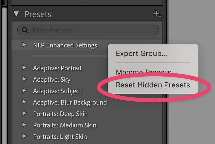

“Could not locate LUTs” in the edit panel.
This message usually means that you have hidden the presets needed for this to work. In the develop module, right click inside of the presets pane on the left and select “Reset hidden presets”
