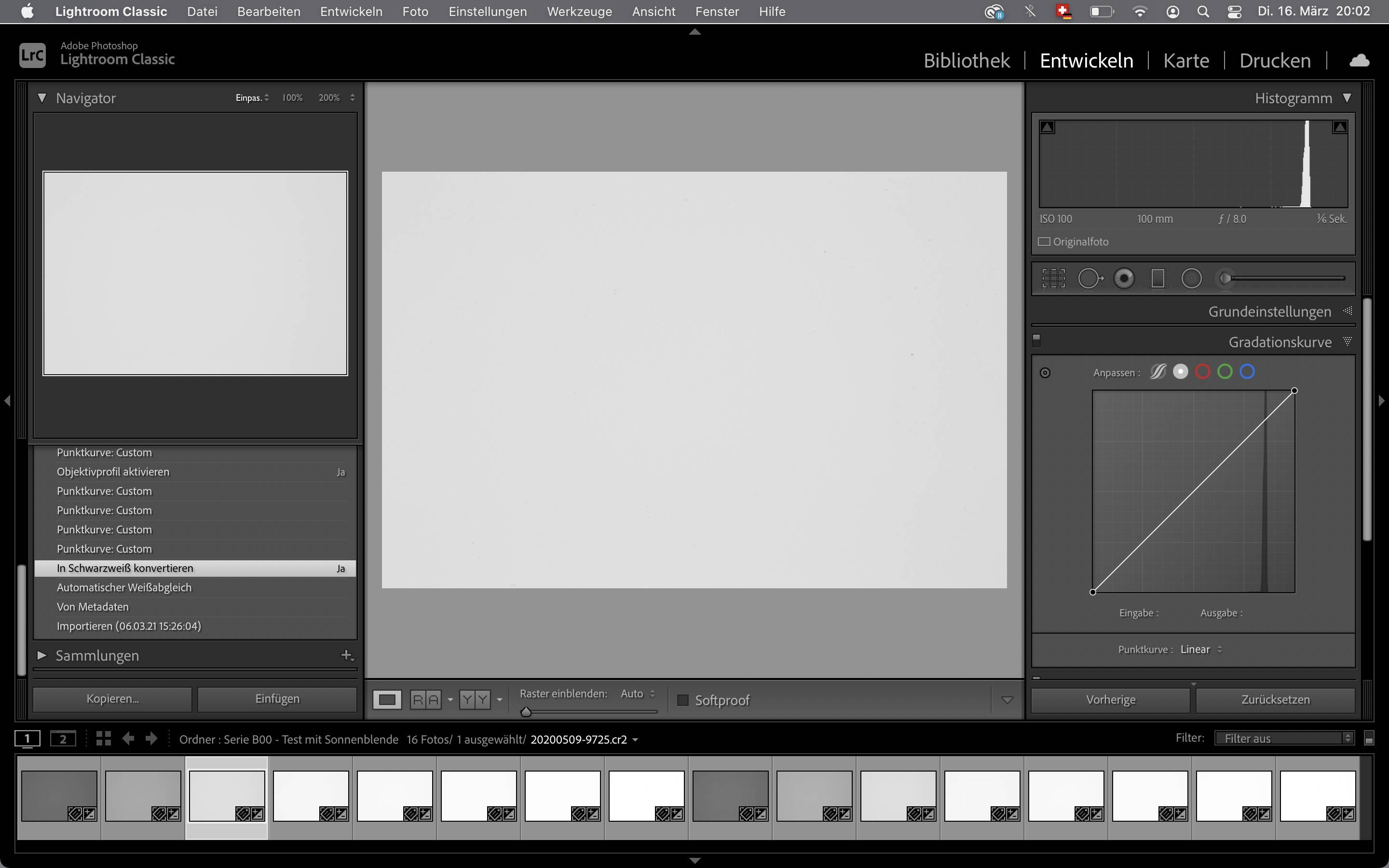

Compare a shot of a central part of an A4 Slimlite Plano:
Without tonal adjustments (check histogram)
With some extreme processing (check histogram)
Note how the extreme processing shows how LEDs are mounted densely and in diamond shape. It also shows lens vignetting and that light shone onto the panel from a window. All this is not relevant or visible under normal working conditions (check filmstrip)
Differences appear greatly exaggerated due to the following:
- tone curve: instead of 1/255, edges are placed at 200/210
- Structure slider at max
- Clarity slider at max
- Haze slider near max

Don’t be discouraged, conversion tonecurves will be nowhere near the curve shown in the lower screenshot. I found that the plano is easily good enough as a backlight.

Here’s a shot of a negative treated with the settings that revealed the diamonds:
I found not the slightest hints of the diamonds, no matter what I did. This extreme treatment brought out the ribbing of the sofa’s covering - and imaged in the medium format negative shot against the light - and it would take a heck of a lot of postprocessing to make it visible in a real image. BTW, I keep my negatives an inch off the surface of the backlight.
