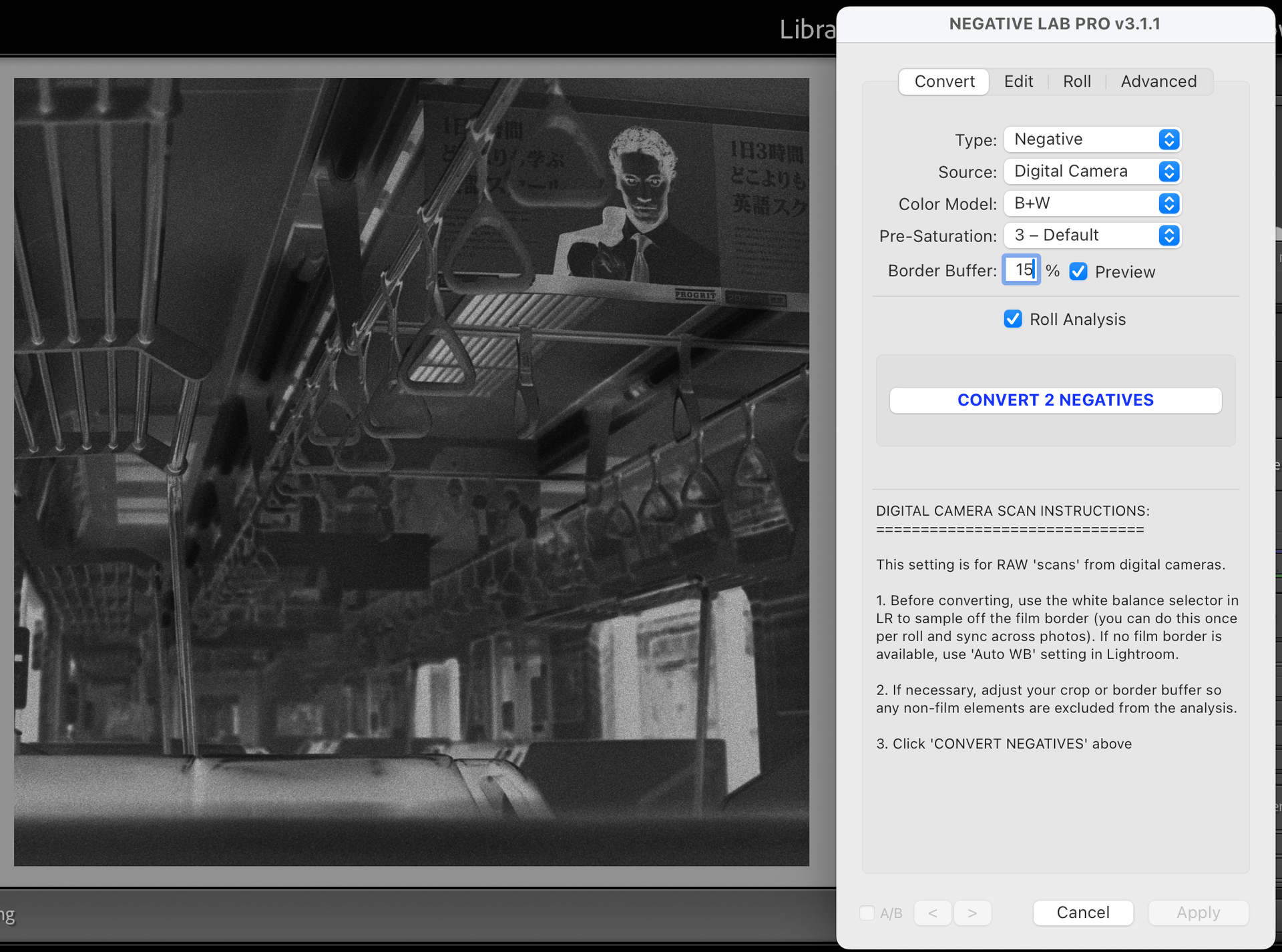

Hey I’d like to ask why the NLP crashes and flashes when I click “convert” in roll analysis mode. The pictures remain unconverted and stop at the border buffer preview as if they are cropped. It functions well if I unselect “roll analysis”. This problem appears both for color negative and B&W modes.
I tried restarting, reinstalling both LrC and NLP. The bug stays the same.

According to some information posted by @nate, there is something of an issue that Adobe has to deal with. Until this has been done, a few workarounds can help. Converting too many images can cause crashes, but that does not seem to be your usual workload (judging from the screen you added)

  • Roll Analysis is meant for colour negative film. Use RA if your negatives aren’t well exposed, i.e. the histograms are narrow and tend to linger at left or right of the Histogram area. Using RA on 2 B&W negatives should not harm, but it most probably doesn’t help either. Leave RA off when you convert B&W negatives.
  • Border Buffer can make things easier, e.g. if you leave your images un-cropped or if there are large areas of high density near the negative’s edges. Enabling BB preview can help to learn how wide a certain BB value is, but calculating the previews takes some time, but has no effect on the conversion (BB value acts on conversion, BB Preview switch does not). If you imagine a thirds grid, you can imagine the effect of a BB setting. A BB setting of 15% corresponds to not quite half of the outer thirds that will be ignored by the conversion.
