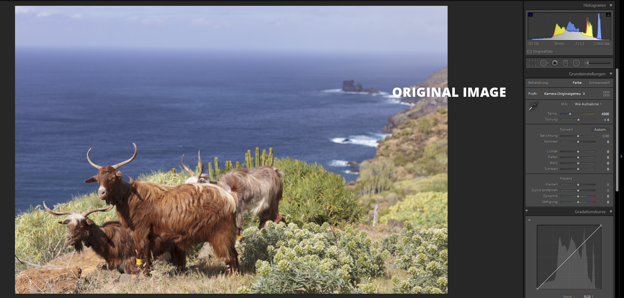

This example worked as expected
Here it jumped back to the initial Profile
